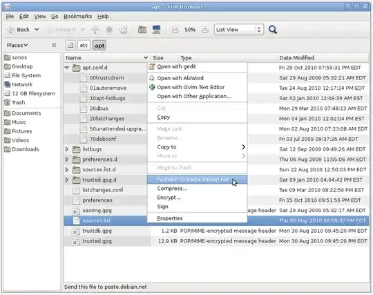

Since you edited your question adding the information that you preferred installing an application from the Ubuntu repos, I will suggest Nautilus Pastebin Configurator (nautilus-pastebin-configurator) from the default Ubuntu 14.04 repositories, even though Nautilus Pastebin Configurator doesn't have as many advanced features which you require as Stikked has. Nautilus Pastebin Configurator is a Nautilus extension written in Python, which allows users to upload text-only files to a pastebin service just by right-clicking on them. After sending the files, a notification will be shown and the paste URL copied into the clipboard.
Users can also customize the extension's behavior just by using nautilus-pastebin-configurator, an easy-to-use configuration tool.
