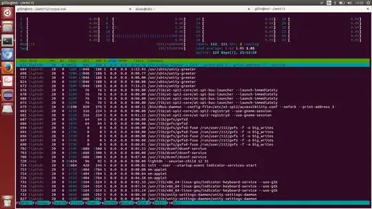

I realized that my server has many processes runned by lightdm:
Can i killall processes from lightdm?
Is sudo killall -u lightdm safe?
