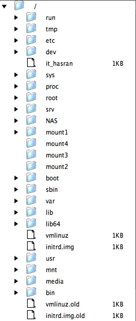

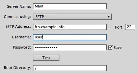

When I log in using dreamweaver and set the root directory as / I can see and edit most things including other virtual hosts directories: enter image description here
Where as when I set the root directory as nothing it takes me straight to the /NAS/$directory/ which is kind of what I want!
But I really just want the user to think that their / directory is /NAS/$directory/
