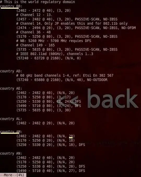

Now here is the interesting part. This is where we actually get to change the regulations. Change your directory to the wireless-regdb folder, and in there you will find a file called db.txt. This is the file we will edit. Let's take a quick look at it:
more db.txt
more of db.txt
  • Now let's take a look at a few things here. Look at what I underlined above. First, let's notice the first entry (country 00) which is the world regulatory domain and this is applied before all else. So when you turn on your BackTrack system, the world domain is applied to you first and then you can change regulatory domains from there to other countries like country AM.
The second thing I underlined, which can go a max of 20 dBm, the third thing I underlined, on the 2.4ghz band. If you wanna change how high you can go, that is the number you want to change.

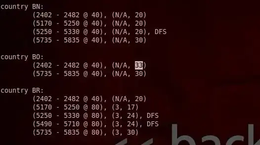

  • For example, let's change Bolivia's rules*
    nano db.txt Scroll down until you find country BO. enter image description here
  • Look at what I highlighted. This is the number we want to change.
If your card can go up to 2000 mW, then you would change that number to 33, which stands for 33 dBm, which is approximately 2000 mW. The number you are replacing is in decibels.

Now, Pay attention.
Notice now I changed the number to 33. When we are finished here, when I change my regulatory domain to BO, i can set my txpower to 33.

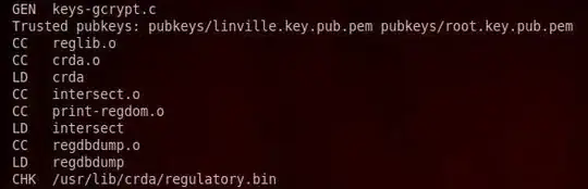

Finally, Now go up a directory from where you are back to the downloaded crda directory and install this puppy.
cd ..
make
make install
You should be seeing something like that. enter image description here
If so, reboot: sudo reboot
