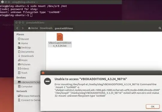

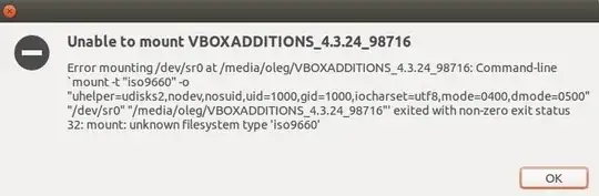

Running Ubuntu 14.04 on Oracle VirtualBox 4.3.24 and completely stuck with mounting guest additions. I've spent quite a time looking for a solution online, but nothing helped...
As suggested below, I've tried to mount manually and also download ISO from the web (version matching VirtualBox). The same error:
EDIT:
Now some folders became "read-only", which causes big troubles.. Even installing fresh Ubuntu 14.04 image doesn't help... So reinstalling of VirtualBox itself...

mount: unknown filesystem type 'iso9660'
This above is the root error you're getting ("unknown filesystem type").
