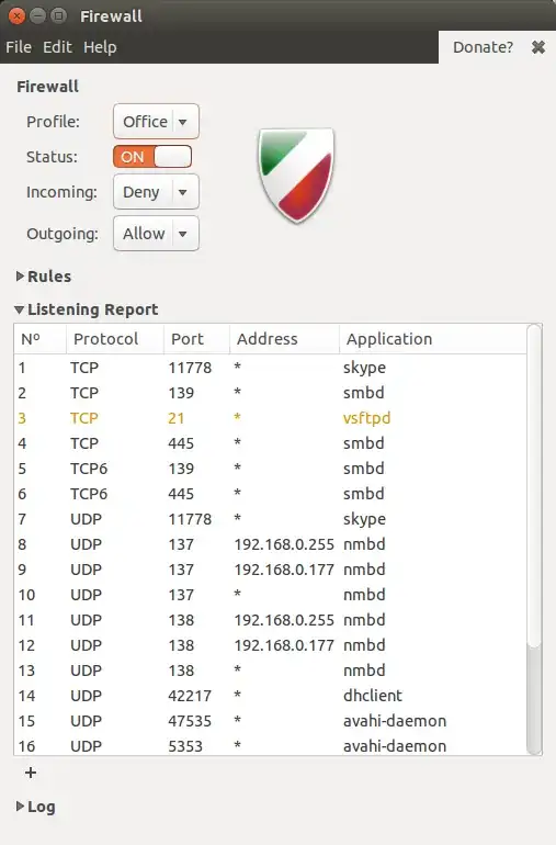

  1. Use gufw's listening report:
    to see whether the packets actually arrive to your machine. This is the simplest way of seeing what's going on.
