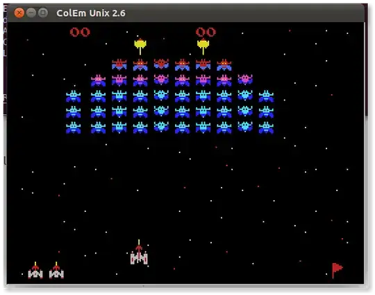

For me the ubuntu binaries from the ColEm download site works fine - however you'll need to use a trick to get it working successfully. Also I found some great retro ROMs that work great with this emulator.
Few steps to follow:
  1. Download the ColEm emulator
  2. Extract the files in a subfolder - for example ~/Downloads/colem
  3. Download some compatible ROMs and unzip these into the colem folder above
  4. Ensure you have the pulseaudio utilities installed:
sudo apt-get install pulseaudio-utils
Now to start the emulator with a particular rom you use the syntax
padsp ./colem32 <rom name>
for example: padsp ./colem32 Galaxian.rom
