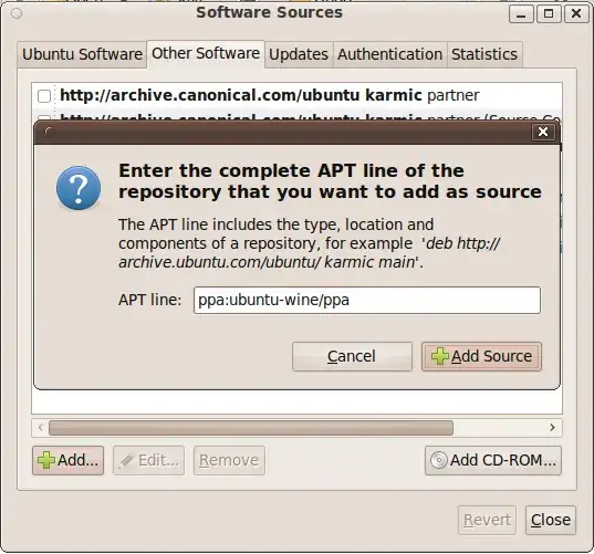

Adding the PPA Repository:
Open the Software Sources menu by launching the Ubuntu Software Center and selecting Edit->Software Sources. Choose the Other Software tab and click Add.
Then, copy and paste the line below.
ppa:ubuntu-wine/ppa
