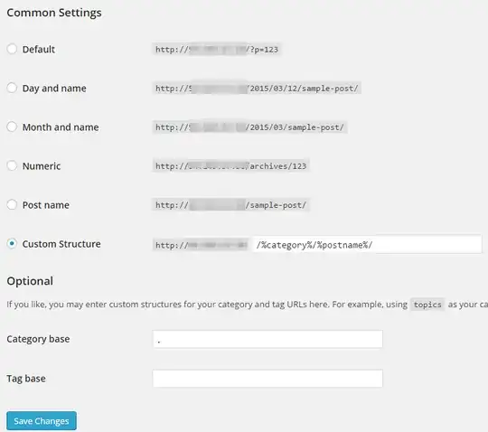

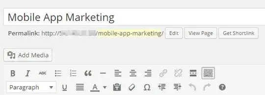

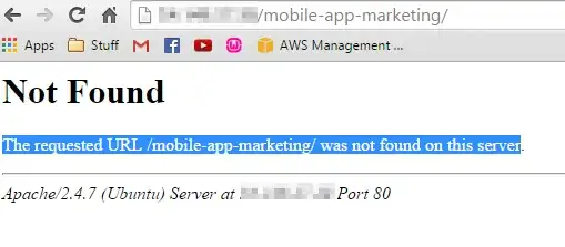

I have been working on a website on an ubuntu server (amazone) and I get 404s entering pages.
I'll give all the information I can regarding the problem.
On WordPress
Refresh page:

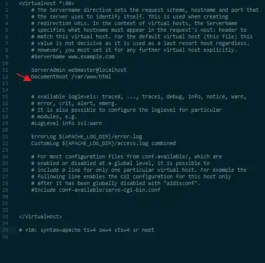

I found this post https://wordpress.org/support/topic/permalink-does-not-work-apart-from-default?replies=12 - so I entered I entered the file: /etc/apache2/sites-enabled/000-default.conf
and didn't find AllowOverride None to change to AllowOverride All So I added it myself here: enter image description here
Restarted apache, and I got an error. I refreshed the website, and found out it's not working..
Undo AllowOverride All from 000-default.conf

Open a terminal and type:
sudo gedit /etc/apache2/apache2.conf
Find this:
<Directory /var/www/>
Change AllowOverride None to AllowOverride All
Then run:
sudo a2enmod rewrite
Dont forget to restart apache2:
sudo service apache2 restart

You would want to tell apache to follow your .htaccess file. You can do this by editing the apache.conf file
$sudo nano /etc/apache2/apache.conf
Scroll down to the line By default it will be:
Options Indexes FollowSymLinks
AllowOverride None
Require all granted
</Directory>
change the value of AllowOverride to All so now it becomes:
AllowOverride All
Require all granted
</Directory>
Press ctrl+x and press y to save the configuration file. In order to make this changes to server first enable the mod_rewrite by.
$ sudo a2enmod rewrite
And then restart the server
$ sudo service apache2 restart
Done!
