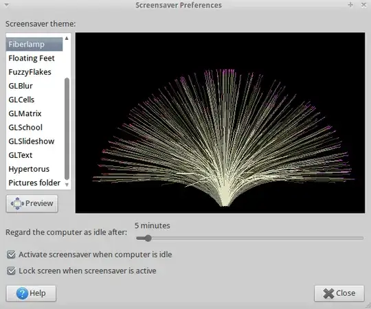

Setting your screen saver
Installing gnome-screensaver also installs gnome-screensaver-preferences.
If you run this in a terminal you will see this screen which will allow you to change from the "black screen" to one of the gnome-screensavers:
