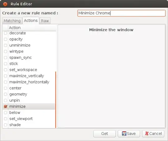

Try gDevilspie
gDevilspie is a graphical front-end for editing the Devilspie configuration file which allows you to run a particular application within a particular way.
Install gdevilspie : sudo apt-get install gdevilspie
