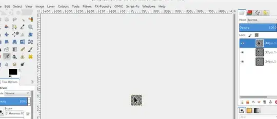

In my standard gimp installation in Ubuntu I can simply open it; see:
% gimp left_ptr
gimp opening a cursor
as you can see, is a multi-layer image with the cursor for different size. If you just keep the biggest one, export to PNG, you have this:
adwaita left_ptr
