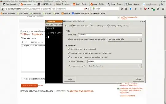

1) Right click on the terminal window and select Profiles -> Profile Preferences
2) Go to Title and Command tab
3) Check "Run a custom command" and in the Custom Command field, add su yourusername
4) Open a new window to check if this works
Suggestions:
- Some users run into a problem with
sucommand, mainly this errorsu initgroups: Operation not permitted. In such case , usesudo su yourusername. If you do that make sure that you add lineDefaults timestamp_timeout=7in/etc/sudoersfile so that after 7 minutes if someone wants to run something with root privileges , the won't be able to, because sudo has timed out. And it's a good security practice in general
