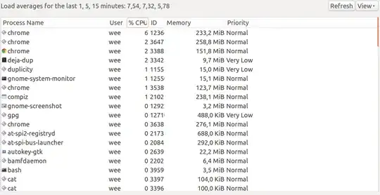

I'm running Ubuntu 14.10 x64 on my Dell XPS 15 9530 laptop. I noticed that my CPU is loaded pretty heavily, although I can't find the process(es) which take(s) these resources.
https://i.sstatic.net/Xx3Xn.png`
Processes sorted by % CPU used enter image description here
Can someone please point out a place to look at?`

If your machine is not one of the fastest, I would assume that the system-monitor CPU-graph window itself is eating the CPU time.
I have Intel Duo 2x2.0GHz and I can't get the displayed load below maybe 50% if that graph window is open.
Go to the settings and adjust the refresh delay to 1sec or so. That should make a huge difference, but at least for me, it does not save this setting.
Or check the CPU usage with other tools like top from the terminal or indicator-multiload (usually has to be installed first), which displays a small graph in your panel.

I found that it's Kidle_inject process which takes my CPU resources.
Thanks all for pointing me the way to see this (command-line Top command, or changing view to "All Processes" in system-monitor).
You can read more about Kidle_inject process problem here.
