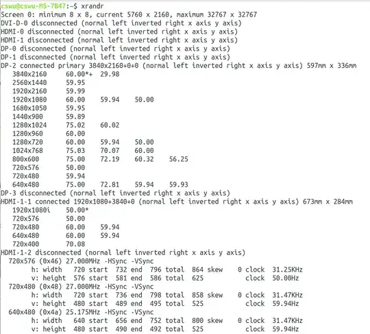

I successfully let it work by following MikaDo's solution in Ubuntu 18.04
OS : ubuntu 18.04
GPU : nvidia 1080ti @ nvidia 410.104 driver / CUDA 10.0
MB: MSI Z370 tomahawk
CPU: intel core i7 8700
Screen1 : LG 29" 21:9 @ 1080ti/DP
Screen2 : PHILIPS 27" 4K @ Intel Graphic/HDMI on motherboard
1.Enable iGPU option in bios and install intel graphic driver
2.Add the following lines in /etc/X11/xorg.conf: (remember to backup before editing)
Section "Device"
    Identifier "intel"
    Driver "modesetting"
EndSection
Section "Screen"
    Identifier "intel"
    Device "intel"
EndSection
3.
sudo xrandr --setprovideroutputsource modesetting NVIDIA-0
sudo xrandr --auto

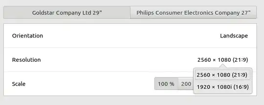

  1. Reboot. Then you'll see 2 screens both display well. (but may not work in correct resolution) enter image description here
5. Follow this tutorial to add display mode
In my case enter image description here enter image description here enter image description here enter image description here
