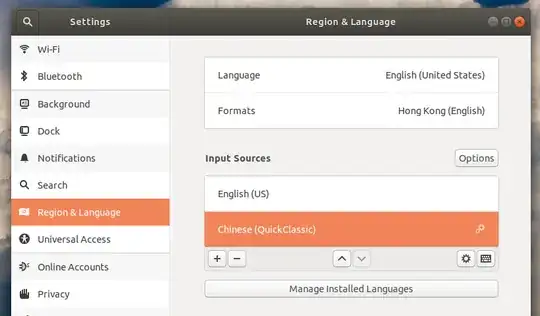

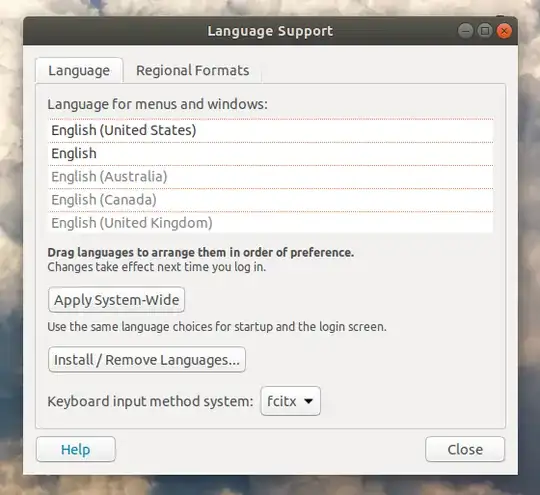

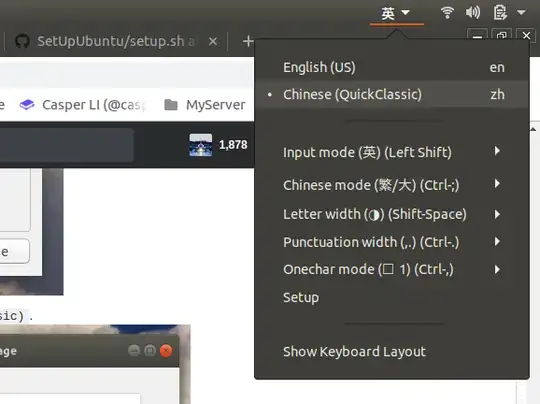

Here I provide a quick way to install Quick Input Method (速成輸入法) in your Ubuntu.
  1. Execute the following command to install the required packages.
    sudo apt-get install fcitx fcitx-imlist fcitx-table-quick-classic
  2. Restart your Ubuntu after the command execution.
  3. Launch Language Support. Set Keyboard input system to fcitx. enter image description here
  4. Launch Region & Language. Add Input Sources: Chinese (QuickClassic). enter image description here
  5. Now you can see the language menu icon. You can use Shift to switch between the input methods.
