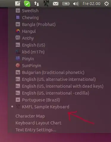

I installed ibus-kmfl in accordance with this guide. By putting the .kmn file in /usr/share/kmfl instead of ~/.kfml, I made the KMFL entry available in the list of input sources in Text Entry.
Input source indicator
