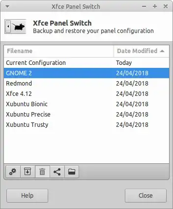

If you are using a Xubuntu 15.10 and later, open XFCE Panel Switch either from Settings Manager or the Whisker Menu (located under Settings).
XFCE Panel Switch settings
You will find various configurations for the Xubuntu panels layout. You can select any of the options presented there and apply it by pressing the gears button. You can also save your current configuration for future use.
