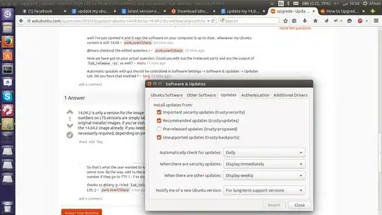

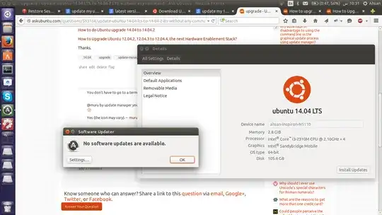

Software Updater says no updates for me
no updates for me
Software Updates Options
14.04.2 is only a version for the image release. The version of Ubuntu itself is still 14.04. The appended numbers on LTS versions are simply later image milestone releases, to differentiate them from the original installer images. If you've installed all the updates, then you have the same packages as are on the 14.04.2 image already. If you need the HWE updates, you can install them, though they are not necessarily required, depending on your hardware.
