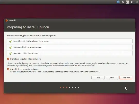

Step 8: Check both boxes

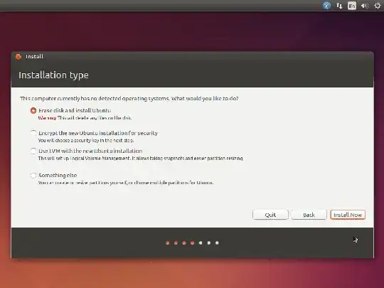

Step 9: Choose something else and click next

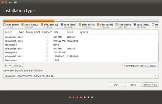

Step 10: Choose /dev/sda in "Device for boot loader installation" and Select partition of type ext 4 for Ubuntu installation (its device name would be something like /dev/sdb1) and click change.
Step 11: Change Mount Point To /
Step 12: Press "Install Now" to continue. Rest process is easy.
