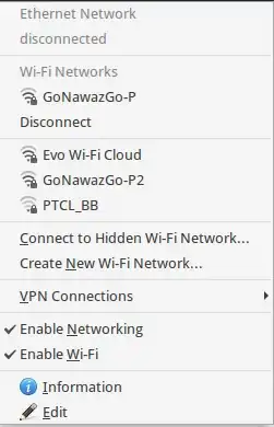

However I can not enable my wifi, I have attached the screen shot as to how it is looking right now.
