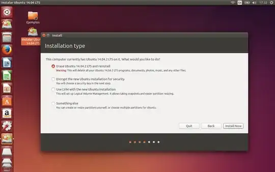

I want to reinstall my UbuntuĀ 14.04.2 (Trusty Tahr), but the option reinstall without loosing data or something like that don't show to me. This is what I get: errase ubuntu 14.04.2 LTS and reinstall
Here a image with the Ubuntu live CD:

Much of the point of re-installing, is that something has gone wrong - so if it kept all your installed programs, it would do nothing. It will however keep your home directory, so you shouldn't lose data - or at least try to..
apt-get does have the facility to do this, package by package: man apt-get:
--reinstall Re-install packages that are already installed and at the newest version.
so you could re-install a broken package, or a few, without a whole start from scratch.
First of all take a full system backup before continuing. (you've been upgraded to user type 4)
As you've kept your /home separate from your /, you need to choose the /dev/mapper/VG1-LVroot and check the "format" check mark in your second screen shot. Then your system will be erased, while your data and configuration settings will be kept.
If however, your problem is not gone afterwards, you should create an additional user and just copy your data directories (Pictures, Documents, ...) over to the new user and leave all other files where they are and then delete the original user, removing it's home directory.
