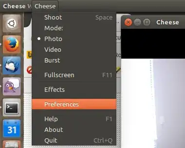

My built in camera doesn't work well, it's damage and have crappy and blurry result, so I use a Logitech webcam. Since I can switch the cams in Skype, I think the same option should be there for Cheese.
I have seen some threads saying to change the cam in Cheese settings, and this is a very stupid question but my Cheese has no settings/preferences or even a menu bar ; just the x, maximize and minimize window, the effects and take photo button.
Where do I access the settings or preferences?

You just need to move your mouse to the upper left corner of your screen to reveal the Cheese Menu:

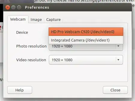

Then open the Preferences to select your device:
