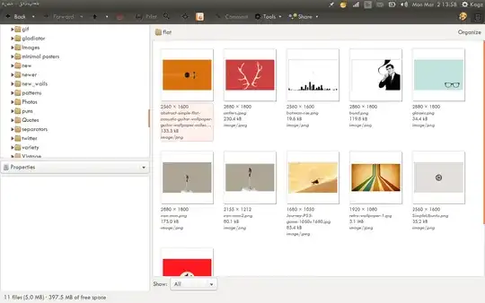

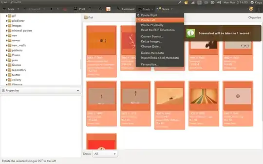

Here's how I do it:
  1. Install gThumb
     sudo apt-get install gthumb
  2. Open up nautilus and go to your images directory. Right click on one and choose Open with -> gthumb.
  3. Under the view menu choose Browser or press the Esc key. This will open the directory browser showing all your images.
  4. Press Ctrl and select the images you want to rotate or select all of them via Ctrl + A.
  5. On the toolbar, select Tools and then Rotate Right or Rotate Left depending on your preference.
