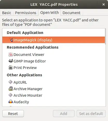

But, double clicking a pdf file opens ImageMagick. A pdf file's Properties shows ImageMagick as the default handler.
ImageMagick is the default handler
Why is this happening ?
After answering the why, also tell me how to solve it using the terminal. I am very fond of using terminal. I tried sudo xdg-mime default evince.desktop application/pdf, nothing changed, even after logging out and back in.

You might find this is a more clear answer that worked for me in Ubuntu 15.10:
  • edit the file ~/.config/mimeapps.list
  • just remove the lines that associate PDF to imagemagick in the file:
    image/pdf=display-im6.desktop
    image/pdf=display-im6.q16.desktop;display-im6.desktop;

I had the same problem and what worked fine for is to delete this file ~/.config/mimeapps.list and now I'm even able to change my defaults and it is getting changed unlike before.

Can't answer either question. However, for folks like myself who just want the fast path to fixing this, when you look at the properties (as shown in your question), simply choose the application you want to be used and "Set as default".
Et voila, it adds an entry to ~/.config/mimeapps.list and you are good to go.

I had the same problem and found the following solution:
$ nano ~/.config/mimeapps.list
and set image/pdf to evince.desktop

I have no idea why but at one moment ImageMagic took over opening of PDFs. I have totally removed reference to pdf from ~/.config/mimeapps.list and pdfs started to open in xreader:
grep -v pdf  ~/.config/mimeapps.list > ~/.config/mimeapps.list1 && mv ~/.config/mimeapps.list1  ~/.config/mimeapps.list
