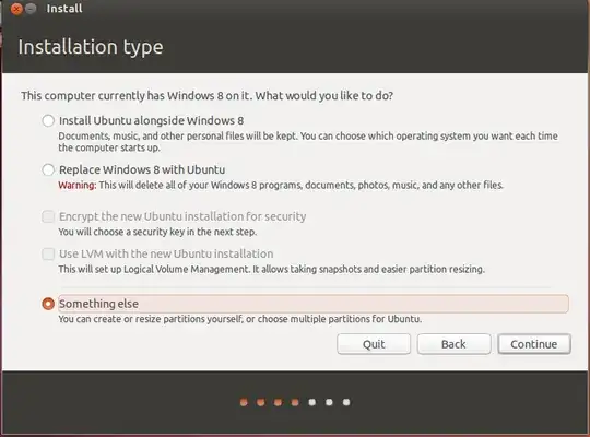

The second important thing is while installing Ubuntu select "Something else".
Enter image description here
It will allow you to select your manually created partition to install Ubuntu onto it.

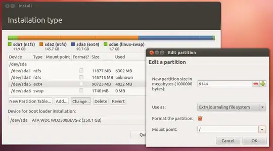

Select the format partition, use as mount point as shown in the image. The size is up to you.

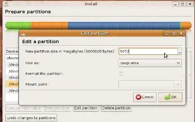

After that, select the swap partition, and edit it as shown in the image (size is your choice).

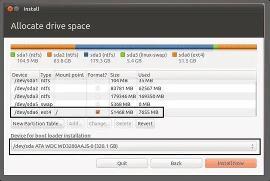

After that select the "Device for boot loader installation" at the bottom and select the one with /dev/sda at the beginning.
Now you can select "install now" at the right bottom.
