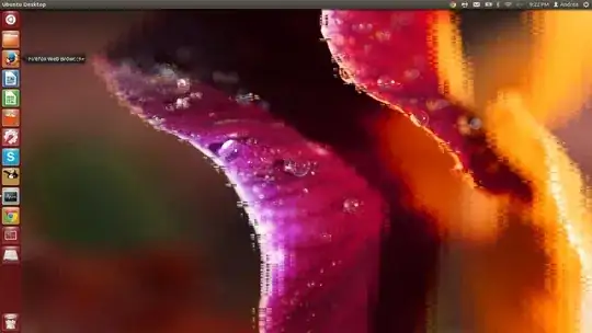

I recently installed Ubuntu 12.04 on an old Sony laptop and I've had a problem I've never seen before. The side bar menu text, the dropdown menu text and sometimes the background image weren't rendering properly. After a system update it got a little better, but still after using the computer for a few days the problem comes back. Here is a screenshot of how it looks like:
The problem persists also when I use Gnome or Unity2D. I don't know if it is a driver issue or a hardware problem or what it is. Has someone else seen this problem and knows what causes it and hopefully how to fix it?
More info:
lspci -nnk | grep -iA2 VGA 00:02.0 VGA compatible controller [0300]: Intel Corporation Mobile 4 Series Chipset Integrated Graphics Controller [8086:2a42] (rev 07)
Subsystem: Sony Corporation Device [104d:9035]
Kernel driver in use: i915

as intel graphics driver is a part of Xorg, I believe the best solution here be:
check if rendering is yes with command:
glxinfo | grep render
for this you need mesa-utils
sudo apt-get install mesa-utils
you should get something like this:
direct rendering: Yes
OpenGL renderer string: GeForce XXXX PCIe/SSE2
GL_KTX_buffer_region, GL_NVX_conditional_render,
GL_OES_fbo_render_mipmap, GL_OES_get_program_binary, GL_OES_mapbuffer,
the last, you can try to reinstall graphics driver:
sudo apt-get install --reinstall xserver-xorg-video-intel
then reboot X
sudo service lightdm restart
or
sudo /etc/init.d/lightdm restart
if it still doesn't work maybe you should file this as a bug.
apport-bug xorg
