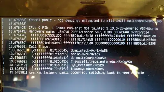

After my computer showed the ubuntu startup screen, the kernel crashed with an error.

Here's a screenshot of the error message: error
Edit: After creating a bootable flash drive via LiLi from ubuntu-14.04.2-desktop-amd64.iso, booting was successful.
Given the kernel panic you've shown (the Windows one might help as well), I would have to wager that this is a memory / RAM issue.

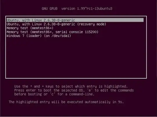

What you should do for the time being to pinpoint the actual issue:
  1. Reboot your machine.
  2. When the boot menu shows up (shown below), select the first Memory Test.
  3. Let it run. Note any errors.
Please post back with any info from the test(s).
Downloading the newest version(14.04.2) and then using LiLi to create the live USB successfully solved the problem.
