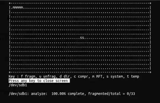

You can use udefrag from E2B https://www.easy2boot.com/make-an-easy2boot-usb-drive/make-using-linux/
Install udefrag zipped static executable (tested with Ubuntu 18.04.4 LTS amd64)
sudo dpkg --add-architecture i386
sudo apt update
sudo apt install libc6:i386 libncurses5:i386 libstdc++6:i386
wget -r https://easy2boot.com/_files/200002026-43f1844ea0/udefrag.zip cd easy2boot.com/_files/200002026-43f1844ea0/ unzip udefrag.zip
sudo chmod 755 * sudo cp udefrag /sbin/
In order to run it (replace sdX1 with the appropriate disk label)
sudo ./udefrag -om /dev/sdX1
udefrag
