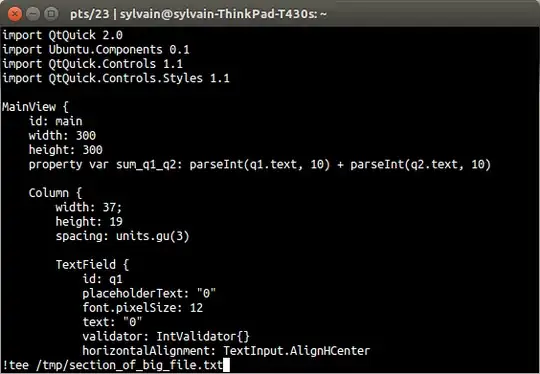

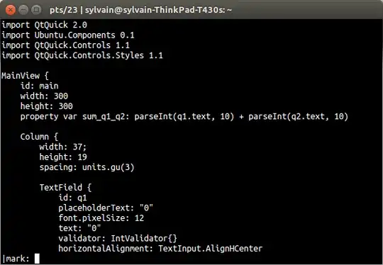

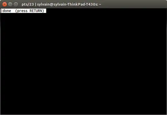

  1. So first type | (the pipe symbol)
  2. Then choose the . mark to select only what's visible on your terminal (or just hit Enter)
  3. Use tee to save to a file e.g. tee /tmp/section_of_big_file.txt
  4. Press Enter then q
The sequence with screenshots:
