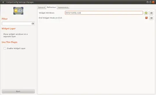

I have a possible solution, but I have not tested it so you will have to comment and tell me if it works.
Add (title=notify-osd) to your Widget Layer match option as follows:
In light of your comment (that this does not seem to work), I suggest reporting a bug against compiz. (ubuntu-bug compiz).
