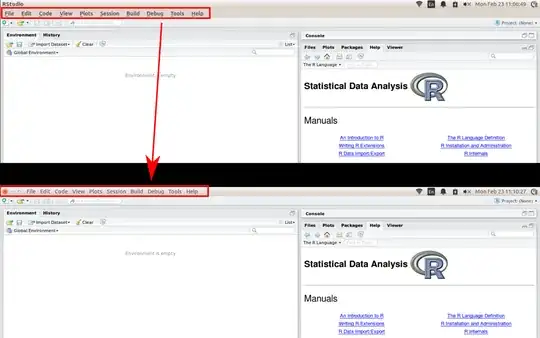

Then (close and) start rstudio. This is how it looks like:
Enable global application menu with RStudio
