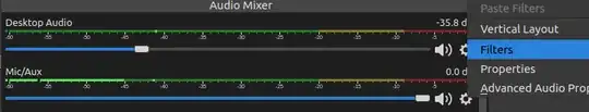

4/ Activate Noise cancellation in OBS:
You have to click on the settings button and then filters as seen on screenshot.
Play with the different ranges to see what works best for you.
