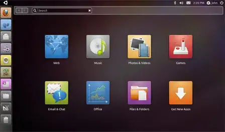

I'm running Ubuntu Desktop 10.10, but I just saw a screenshot of Ubuntu Netbook Edition and I'd like to try it out.
screenshot
Is it possible to install just the netbook desktop interface and then switch between it and the normal GNOME desktop?
