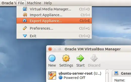

Open VirtualBox and enter into the File option to choice Export Appliance...
at the top left corner, then file and export appliance

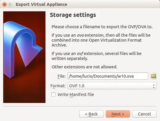

  2. Enter the output file path and name
    be careful with the output path and file name making sure to leave the file extension untouched
    You can choice a format, which I always leave the default OVF 1.

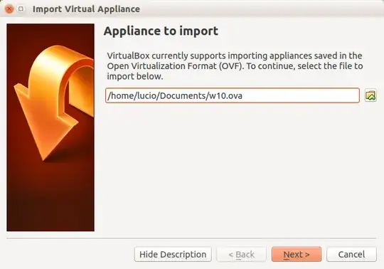

  1. Enter the path to the file that you have previously exported
    chose the previously generated file

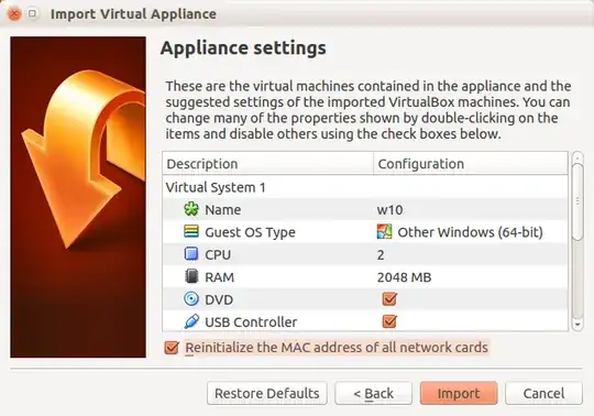

  2. Then you can modify the settings of the VM like RAM size, CPU, etc.
    give a configuration according to your system, not all of it but enough
    My recommendation on this is to enable the Reinitialize the MAC address of all the network cards option
  3. Press Import and done!
