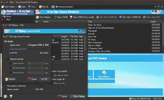

I'd give you my advices on K3b it's still by far the best tool in Ubuntu of its kind for me and if you configure it right. You can rip and choose bitrate (vbr) and encode your files to any .ogg,.mp3,.flacetc. And the choice is after you of course.
So, we need to install K3b:
sudo apt-get update && sudo apt-get upgrade
sudo apt-get install k3b
Now we'll need some additional packages to work with audio:
sudo apt-get install libk3b6-extracodecs
sudo apt-get install kde-config-cddb
And at last we'll need some more codecs to encode .mp3 and .flac:
sudo apt-get install lame
sudo apt-get install flac
Done. Now you'll get plenty enough options to rip (audio cd) with.
