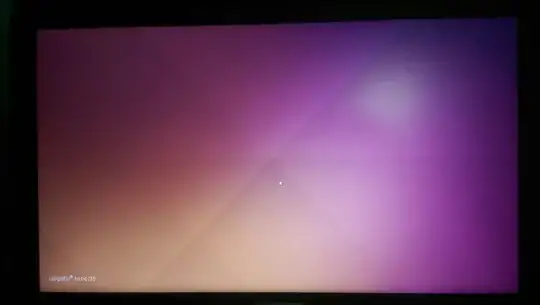

I have a problem that may sound already heard, but I can't find a proper driver for my Clevo laptop with a GTX970M, using Ubuntu 14.04 64bit uefi, here are the ways I tried:
  • Installed version 346.35 from xorg-edgers ppa, here is what I get: initially seems a normal boot, but after boot logo some coloured pixels appear on the screen then it becomes completely black. I can hear the login page welcome sound, and I can even log in (without seeing what happens underneath) but all I can do is switching to command line and uninstall drivers, then reboot and everything works on integrated graphics.
  • Installing official drivers (346.35) from Nvidia website manually (following the right procedure) leads to a normal boot, login window, I can type my password and log in, then it stuck on this: no desktop and all I can do is repeat the same procedure as the first point and rely upon integrated graphics again.
