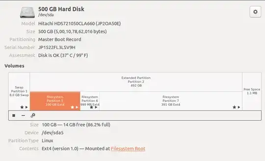

This is the condition of my current partition.
Disk Properties
I have 8 GB of swap space. The extended partition has 492 GB among which only 100 GB is usable, which is /dev/sda5. Then a 1 GB boot partition, which is /dev/sda6. And then there is a 391 GB file system partition /dev/sda7 which is almost empty. Is it possible for me to add this space to me /home directory?
Additional Information: When I checked my disk properties it was shown that this empty partition is mounted as /Foo. (i.e., inside the root folder). But this space is not shown when we check the properties of computer (root). But there is a folder inside root as /Foo and when I check the properties of that folder It shows It has more than 360 GB free space. Since the owner is root,I am unable to copy anything to this folder as a normal user.
My file system type is ext4.
Please feel free to ask if any additional information required.

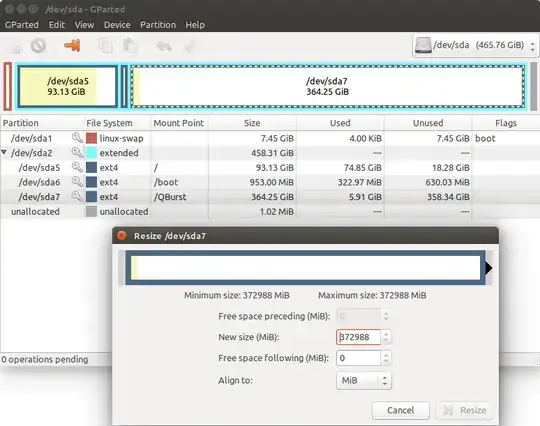

This is my GParted screenshot when opened with Gksudo. enter image description here
  • Ensure your computer is plugged into the power
  • Make a System Backup (You've just been promoted to User type 4)
  • Boot from an Ubuntu Live-DVD or a gparted Live-CD
  • Start gparted and you will see something like this:
  • Click the right side of /dev/sda7 and drag it to the left (="shrink partition")
  • Move the partitions around, so there is enough space to:
  • Click the right side of /dev/sda5 and drag it to the right (="grow partition")
  • Click the green
  • Go to sleep as this is going to take all night!

If you join / remove a partition, be sure to remove it from /etc/fstab also: else the OS keeps looking for it.
