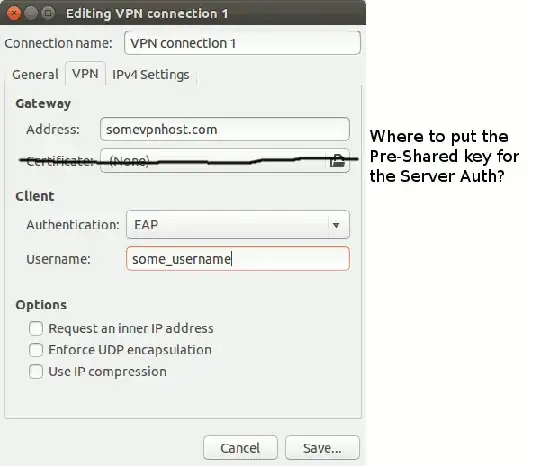

Since then, I've been trying to figure out how to use Pre-Shared Keys for Authentication to the Server. As shown in the screenshot, the Network Manager allows for a Certificate (.pem file), but not a Pre-shared key.

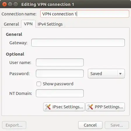

I can see on this screenshot where to put the server name and username, but cannot see where to put the PSK for the server, nor where to enter the password (maybe I'm prompted for that at connection time.)

The plug-in for network manager now shows a Pre-shared Key option, but it still doesn't work. It now looks like this:
The problem with this is that the "Certificate" option is still being displayed (instaed of the Pre-shared key field.)
Where in this Ubuntu Network Manager plugin am I supposed to enter the Pre-shared Key for Server authentication?

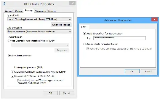

As an example for contrast, in Windows 8, it has an option that looks like this:

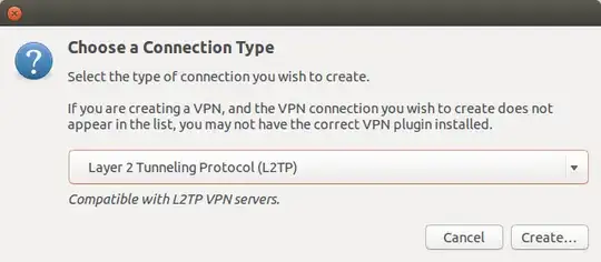

After you install the package you will be able to configure an L2TP connection in Network Manager

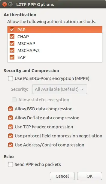

enter image description here enter image description here enter image description here enter image description here
