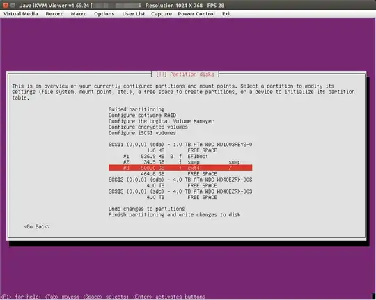

I suppose a direct 'yes' solution to your question is to ensure your machine boots in UEFI-only mode. This worked flawlessly for me on a SuperMicro X11 mainboard with the official 14.04.4 server installer. I did have to change the BIOS boot mode from "DUAL" (which also allows "LEGACY" boots) to "UEFI".
This yielded a /dev/sda root disk that was GPT partitioned (with a bootable fat32 partition type EF00) without any manual intervention. I was also able to adjust the "guided" partitioning - just because I wanted different sizes and layout, there was no need to do anything special relating to GPT.
It would be interesting to know if there are any downsides to booting in UEFI mode. Can't help but think the technology's been around long enough for issues to have been ironed out...
see also attached screenshot

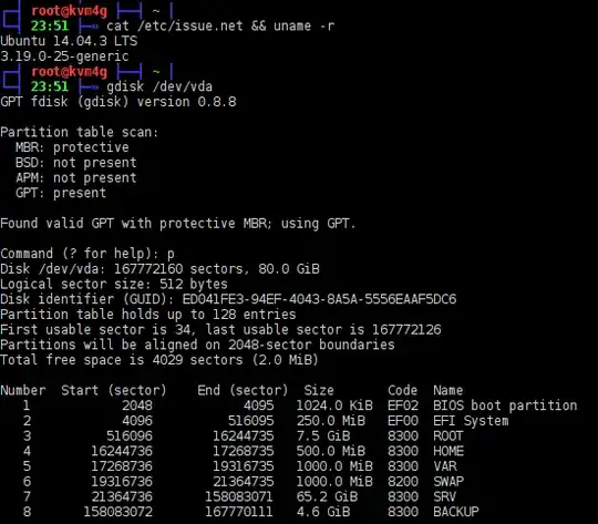

The simplest way for me was to boot into the the existing installation :
apt-get install gdisk gdisk /dev/vda
& write (option o in gdisk) a GPT partition table (which allocated 1 MiB of space at the beginning & end of the disk & preserved a protected copy of the MBR).
I then rebooted from the CD & chose Rescue Mode& mounted the root partition from the existing installation & ran :
/sbin/gdisk /dev/vda
& created the gpt partitions setting the correct partition types :
You will need to reboot the machine again so the kernel reads the new partition table & begin the installation.
During installation I set :
Partition 1:
1 MiB EF02 as filesystem type reserved-bios
Partition 2:
250 MiB EF00 as ext4 with noatime,nodiratime mounted @ /boot & marked bootable
