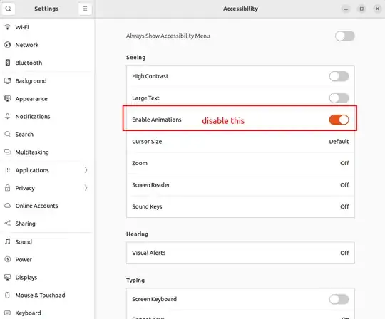

In case anyone comes across this for Ubuntu 22.04 jammy, you can turn it off in Settings under Accessibility -> Enable Animations:
Enable Animations Setting Under Accessibility Menu

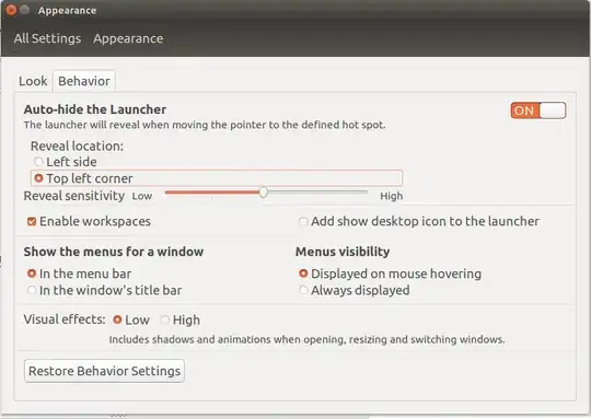

Applications -> Appearance -> Behaviour -> Set Visual Effects to Low
On a Side note: Eventually, I ended up reverting back to animations, because the sudden switch from my dark code screen to something to light backgrounds like browsers was too much for my eyes.
