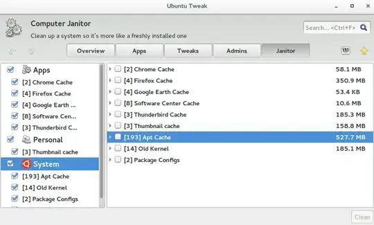

For the file part, you can install Ubuntu Tweak and use the janitor module:
Ubuntu Tweak Janitor
See also How safe is Ubuntu tweak's Janitor?. You can also install it using a PPA, look here in WebUpd8 (it's still ok for 14.04).
