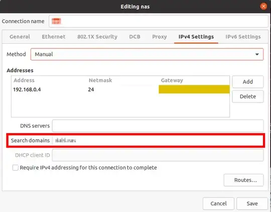

From 16.04 on, the Advanced Network Configuration tool is only accessible via the command line:
sudo nm-connection-editor
The search domain can be configured on the IPvX Settings tab.
For further details, see Thomas Ward's excellent answer.
