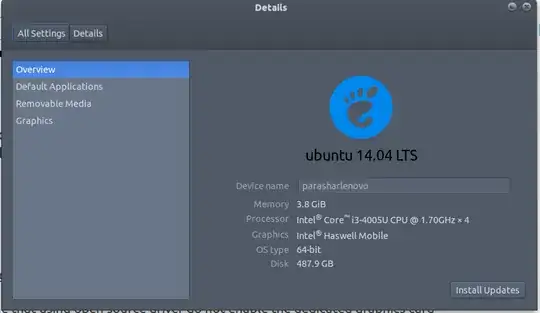

My Ubuntu 14.04 in Lenovo b40-70 do not detect my AMD/ATI Radeon HD 8550M / R5 M230 , it shows only Intel integrated graphics card here's the output :
00:02.0 VGA compatible controller: Intel Corporation Haswell-ULT Integrated Graphics Controller (rev 0b)

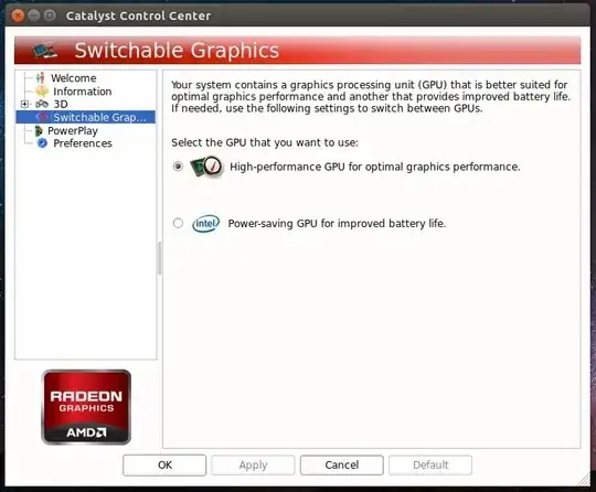

I've tried both xorg driver and fglrx from additional hardware section and still the output of lspci | grep VGA remains same

please help me out , I want to use the xorg driver as it keeps my laptop cooler and I am able to use wacom tablet. i do not want to switch to windows 7 after using Ubuntu for 4 years on my old dell laptop.
what is best way to make use of the open source driver with the graphics switching if possible.
