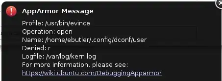

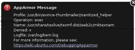

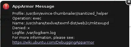

If a browse a nautilus folder that contains a .dvi file, I get errors that pop onto my screen:
I think that this is due to the thumbnailer processing the file. I don't care about getting thumbnails for dvi files.
How can I stop this happening?
