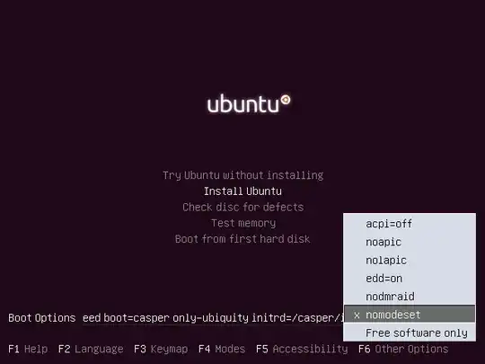

You're probably running into a graphics issue. If you press E to edit you will see:
then press F6 and select nomodeset. This will allow you to continue to the next screen and finish the installation.
After that, you will probably have to update your graphics drivers. If you would run into problems there, just ask a question and have your graphics hardware details ready.
