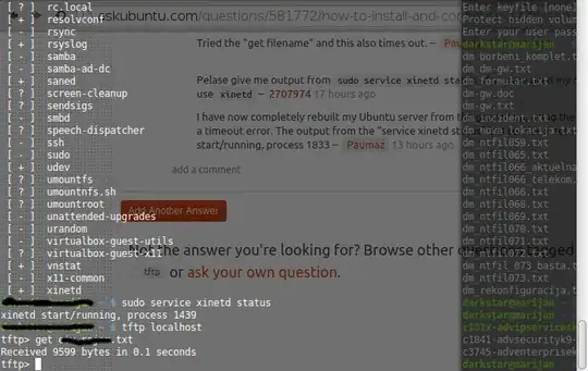

Just the same problem here. Old Ubuntu 9.? that has upgraded to 14.04 by clicking "Yes". User is defined from "before" (default everything).
I've found it to work with:
tftp AAA.DDD.DDD.RRR
get test
^D
cat test
This works, where AAA.DDD.DDD.RRR is the actual IP of my own machine.
(I currently have a static local offline net, so eg: tftp 192.168.1.1 is given as command)
Replacing this numeric address with the word "localhost" ==> Timeout at "get"
(it seems to connect ok, but it can't get the files).
