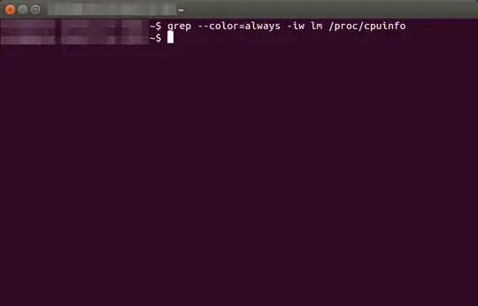

One way you can tell if you've got a 32 bit or 64 bit CPU is by running grep --color=always -iw lm /proc/cpuinfo in Terminal (Ctrl+Alt+T). If it returns lm (Long Mode) as one of the flags, you've got a 64 bit CPU. cc Community Wiki.
You can see in this screenshot of my terminal on my laptop with a 32 bit CPU that nothing is returned for that command:
