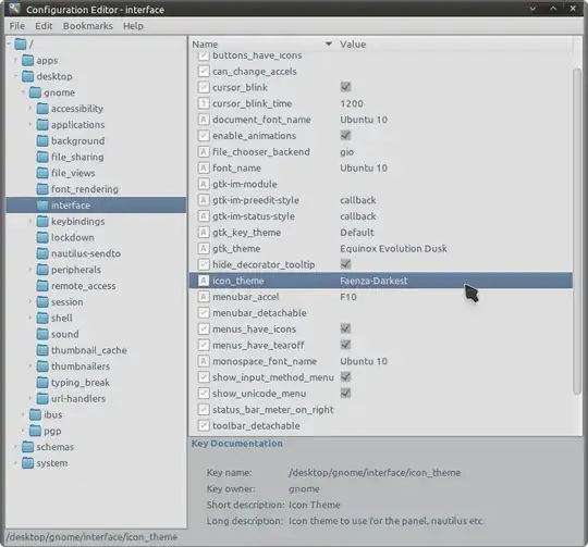

A reference to the current icon theme can be found in gconf-editor at:
desktop > gnome > interface > icon_theme
You can alternatively read directly ~/.gconf/desktop/gnome/interface$ cat %gconf.xml file.
Unfortunately, this does not provide a path to the relevant icon theme. I'll check how this setting relates to the path and i'll let you know ;-)
