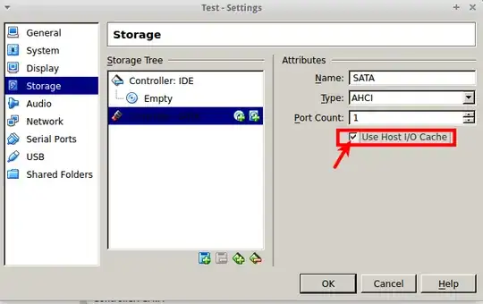

Please check if the VBoxSVC service is still running when you try to start the VM with VBox 4.3.18.
Make sure that you have the use I/O APIC, and the Use host I/O cache options are checked.
Also you may want to upgrade to 4.3.20, since it have a lot of fixes over 4.3.18.
